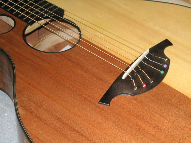

re: break angle at the saddle. Here are a couple of pictures (not the best quality) that shows how break angle is addressed on my version of the pinless bridge. The strings are passed under the head of a button head cap screw that can be adjusted up or down allowing adjustment of the break angle. By tightening the cap screws the break angle is increased by pulling the pivot point closer to the bridge.
Jimmy Caldwell

Jimmy, that's pretty cool! Can you show us a close-up of the side of those pins? And, are those anchors piano wire like Mike Doolin uses?
Very sharp looking...

Jimmy
   That is a very creative bridge. In fact the entire guitar looks very original and nice.
PostPosted: Fri Nov 04, 2005 1:06 am
I like two things on this set-up
1) The step brake angle induced by the buttons
2) The deep foot print of the bridge (more glued surface area.) I have repaired several pinless bridges that have pulled lose that were more like the Ovation pinless. A note here Ovation bolts their bridges to solve this issue.
